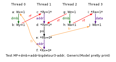

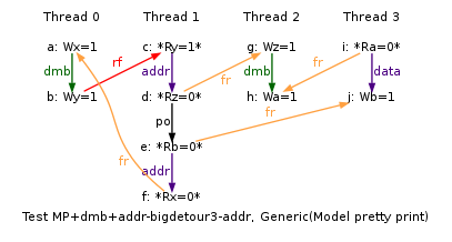

ARM MP+dmb+addr-bigdetour3-addr
"DMBdWW Rfe DpAddrdR Leave Fre DMBdWW Rfe DpDatadW Back Rfe DpAddrdR Fre"
Prefetch=0:x=F,0:y=W,1:y=F,1:x=T,2:z=F,2:a=W,3:a=F,3:b=W
Com=Rf Fr Rf Rf
Orig=DMBdWW Rfe DpAddrdR Leave Fre DMBdWW Rfe DpDatadW Back Rfe DpAddrdR Fre
%x0=x; %y0=y;
%y1=y; %z1=z; %b1=b; %x1=x;
%z2=z; %a2=a;
%a3=a; %b3=b;
P0 | P1 | P2 | P3 ;
MOV R0,#1 | LDR R0,[%y1] | MOV R0,#1 | LDR R0,[%a3] ;
STR R0,[%x0] | EOR R1,R0,R0 | STR R0,[%z2] | EOR R1,R0,R0 ;
DMB | LDR R2,[R1,%z1] | DMB | ADD R1,R1,#1 ;
MOV R1,#1 | LDR R3,[%b1] | MOV R1,#1 | STR R1,[%b3] ;
STR R1,[%y0] | EOR R4,R3,R3 | STR R1,[%a2] | ;
| LDR R5,[R4,%x1] | | ;
