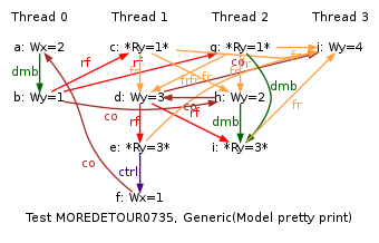

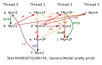

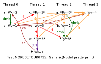

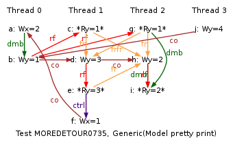

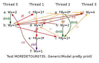

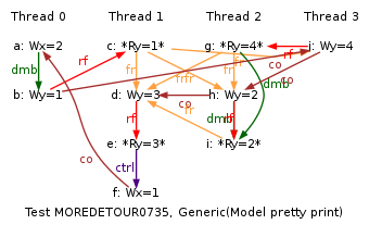

Executions for behaviour: "1:R0=1 ; 1:R2=3 ; 2:R0=0 ; 2:R2=1 ; x=2"
Executions for behaviour: "1:R0=1 ; 1:R2=3 ; 2:R0=4 ; 2:R2=1 ; x=2"
Executions for behaviour: "1:R0=1 ; 1:R2=3 ; 2:R0=0 ; 2:R2=2 ; x=2"
Executions for behaviour: "1:R0=1 ; 1:R2=3 ; 2:R0=1 ; 2:R2=2 ; x=2"
Executions for behaviour: "1:R0=1 ; 1:R2=3 ; 2:R0=3 ; 2:R2=2 ; x=2"
Executions for behaviour: "1:R0=1 ; 1:R2=3 ; 2:R0=4 ; 2:R2=2 ; x=2"
Executions for behaviour: "1:R0=1 ; 1:R2=3 ; 2:R0=0 ; 2:R2=3 ; x=2"
Executions for behaviour: "1:R0=1 ; 1:R2=3 ; 2:R0=1 ; 2:R2=3 ; x=2"
Executions for behaviour: "1:R0=1 ; 1:R2=3 ; 2:R0=4 ; 2:R2=3 ; x=2"
Executions for behaviour: "1:R0=1 ; 1:R2=3 ; 2:R0=0 ; 2:R2=4 ; x=2"
Executions for behaviour: "1:R0=1 ; 1:R2=3 ; 2:R0=1 ; 2:R2=4 ; x=2"
Executions for behaviour: "1:R0=1 ; 1:R2=3 ; 2:R0=3 ; 2:R2=4 ; x=2"
ARM MOREDETOUR0735
"DMBdWW Rfe DetourRW DetourW DpCtrldW Wse"
Cycle=Rfe DetourRW DetourW DpCtrldW Wse DMBdWW
Prefetch=0:x=F,0:y=W,1:y=F,1:x=W
Com=Rf Ws
Orig=DMBdWW Rfe DetourRW DetourW DpCtrldW Wse
%x0=x; %y0=y;
%y1=y; %x1=x;
%y2=y;
%y3=y;
P0 | P1 | P2 | P3 ;
MOV R0,#2 | LDR R0,[%y1] | LDR R0,[%y2] | MOV R0,#4 ;
STR R0,[%x0] | MOV R1,#3 | MOV R1,#2 | STR R0,[%y3] ;
DMB | STR R1,[%y1] | STR R1,[%y2] | ;
MOV R1,#1 | LDR R2,[%y1] | DMB | ;
STR R1,[%y0] | CMP R2,R2 | LDR R2,[%y2] | ;
| BNE LC00 | | ;
| LC00: | | ;
| MOV R3,#1 | | ;
| STR R3,[%x1] | | ;
