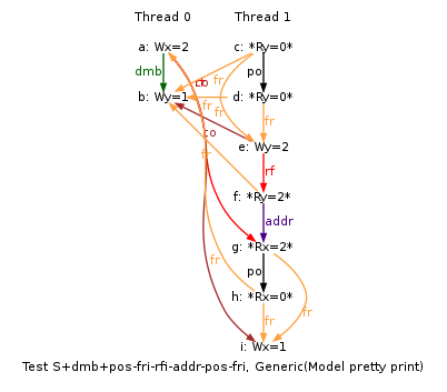

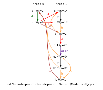

Test S+dmb+pos-fri-rfi-addr-pos-fri
Executions for behaviour: "1:R0=0 ; 1:R1=0 ; 1:R3=2 ; 1:R5=2 ; 1:R6=0 ; x=1 ; y=1"
Executions for behaviour: "1:R0=0 ; 1:R1=0 ; 1:R3=2 ; 1:R5=2 ; 1:R6=0 ; x=1 ; y=2"
Executions for behaviour: "1:R0=1 ; 1:R1=1 ; 1:R3=2 ; 1:R5=2 ; 1:R6=0 ; x=1 ; y=2"
Executions for behaviour: "1:R0=1 ; 1:R1=1 ; 1:R3=2 ; 1:R5=0 ; 1:R6=0 ; x=2 ; y=2"
ARM S+dmb+pos-fri-rfi-addr-pos-fri
"DMBdWW Rfe PosRR Fri Rfi DpAddrdR PosRR Fri Wse"
Cycle=Rfi DpAddrdR PosRR Fri Wse DMBdWW Rfe PosRR Fri
Com=Rf Ws
Orig=DMBdWW Rfe PosRR Fri Rfi DpAddrdR PosRR Fri Wse
 P0           | P1              ;
 MOV R0,#2    | LDR R0,[%y1]    ;
 STR R0,[%x0] | LDR R1,[%y1]    ;
 DMB          | MOV R2,#2       ;
 MOV R1,#1    | STR R2,[%y1]    ;
 STR R1,[%y0] | LDR R3,[%y1]    ;
              | EOR R4,R3,R3    ;
              | LDR R5,[R4,%x1] ;
              | LDR R6,[%x1]    ;
              | MOV R7,#1       ;
              | STR R7,[%x1]    ;
    1:R0=0; 1:R1=0; 1:R3=2; 1:R5=2; 1:R6=0; x=1; y=1;
and 1:R0=0; 1:R1=0; 1:R3=2; 1:R5=2; 1:R6=0; x=1; y=2;
and 1:R0=1; 1:R1=1; 1:R3=2; 1:R5=2; 1:R6=0; x=1; y=2;
and 1:R0=1; 1:R1=1; 1:R3=2; 1:R5=0; 1:R6=0; x=2; y=2;
