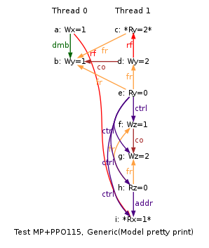

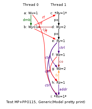

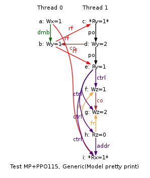

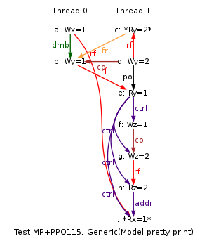

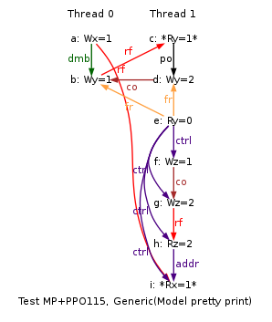

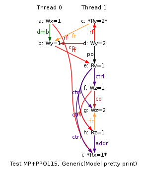

Test MP+PPO115
Executions for behaviour: "1:R0=1 ; 1:R7=1 ; y=1 ; z=2"
Executions for behaviour: "1:R0=2 ; 1:R7=1 ; y=1 ; z=2"
ARM MP+PPO115
"Fre DMBdWW Rfe PosRW PosWR DpCtrldW PosWW PosWR DpAddrdR"
Cycle=Rfe PosRW PosWR DpCtrldW PosWW PosWR DpAddrdR Fre DMBdWW
Relax=
Safe=Rfe Fre PosWW PosWR PosRW DMBdWW DpAddrdR DpCtrldW
Prefetch=1:x=T
Orig=Fre DMBdWW Rfe PosRW PosWR DpCtrldW PosWW PosWR DpAddrdR
%x0=x; %y0=y;
%y1=y; %z1=z; %x1=x;
 P0            | P1               ;
 MOV R0, #1    | LDR R0, [%y1]    ;
 STR R0, [%x0] | MOV R1, #2       ;
 DMB           | STR R1, [%y1]    ;
 MOV R1, #1    | LDR R2, [%y1]    ;
 STR R1, [%y0] | CMP R2, R2       ;
               | BNE LC00         ;
               | LC00:            ;
               | MOV R3, #1       ;
               | STR R3, [%z1]    ;
               | MOV R4, #2       ;
               | STR R4, [%z1]    ;
               | LDR R5, [%z1]    ;
               | EOR R6,R5,R5     ;
               | LDR R7, [R6,%x1] ;
Observed
    1:R0=1; 1:R7=1; y=1; z=2;
and 1:R0=2; 1:R7=1; y=1; z=2;
