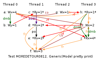

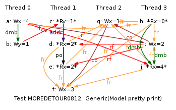

Executions for behaviour: "1:R0=1 ; 1:R2=2 ; 1:R3=2 ; 3:R0=0 ; 3:R2=4 ; x=3"
Executions for behaviour: "1:R0=1 ; 1:R2=2 ; 1:R3=2 ; 3:R0=1 ; 3:R2=4 ; x=3"
ARM MOREDETOUR0812
"DMBdWW Rfe DpAddrdR DetourR DetourRW Wse"
Cycle=Rfe DpAddrdR DetourR DetourRW Wse DMBdWW
Prefetch=0:x=F,0:y=W,1:y=F,1:x=W
Com=Rf Ws
Orig=DMBdWW Rfe DpAddrdR DetourR DetourRW Wse
%x0=x; %y0=y;
%y1=y; %x1=x;
%x2=x;
%x3=x;
P0 | P1 | P2 | P3 ;
MOV R0,#4 | LDR R0,[%y1] | MOV R0,#1 | LDR R0,[%x3] ;
STR R0,[%x0] | EOR R1,R0,R0 | STR R0,[%x2] | MOV R1,#2 ;
DMB | LDR R2,[R1,%x1] | | STR R1,[%x3] ;
MOV R1,#1 | LDR R3,[%x1] | | DMB ;
STR R1,[%y0] | MOV R4,#3 | | LDR R2,[%x3] ;
| STR R4,[%x1] | | ;
Observed
1:R0=1; 1:R2=2; 1:R3=2; 3:R0=0; 3:R2=4; x=3;
and 1:R0=1; 1:R2=2; 1:R3=2; 3:R0=1; 3:R2=4; x=3;
