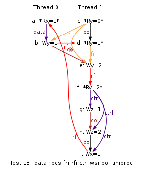

ARM LB+data+pos-fri-rfi-ctrl-wsi-po
"DpDatadW Rfe PosRR Fri Rfi DpCtrldW Wsi PodWW Rfe"
Cycle=Rfi DpCtrldW Wsi PodWW Rfe DpDatadW Rfe PosRR Fri
Prefetch=0:x=F,0:y=W,1:y=F,1:x=W
Com=Rf Rf
Orig=DpDatadW Rfe PosRR Fri Rfi DpCtrldW Wsi PodWW Rfe
%x0=x; %y0=y;
%y1=y; %z1=z; %x1=x;
P0 | P1 ;
LDR R0,[%x0] | LDR R0,[%y1] ;
EOR R1,R0,R0 | LDR R1,[%y1] ;
ADD R1,R1,#1 | MOV R2,#2 ;
STR R1,[%y0] | STR R2,[%y1] ;
| LDR R3,[%y1] ;
| CMP R3,R3 ;
| BNE LC00 ;
| LC00: ;
| MOV R4,#1 ;
| STR R4,[%z1] ;
| MOV R5,#2 ;
| STR R5,[%z1] ;
| MOV R6,#1 ;
| STR R6,[%x1] ;
Observed
0:R0=1; 1:R0=0; 1:R1=1; 1:R3=2; y=2; z=2;
