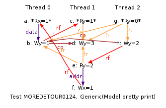

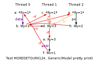

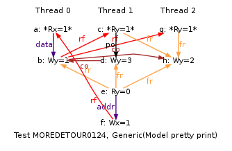

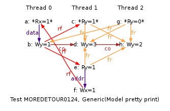

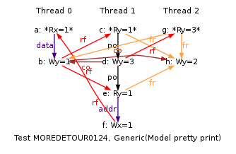

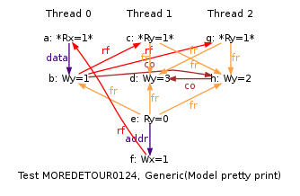

Executions for behaviour: "0:R0=1 ; 1:R0=1 ; 2:R0=0 ; y=2"
Executions for behaviour: "0:R0=1 ; 1:R0=1 ; 2:R0=1 ; y=2"
Executions for behaviour: "0:R0=1 ; 1:R0=1 ; 2:R0=3 ; y=2"
Executions for behaviour: "0:R0=1 ; 1:R0=1 ; 2:R0=0 ; y=3"
Executions for behaviour: "0:R0=1 ; 1:R0=1 ; 2:R0=1 ; y=3"
