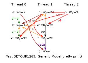

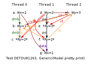

Executions for behaviour: "0:R2=3 ; 1:R1=1 ; 1:R2=2 ; x=1"
Executions for behaviour: "0:R2=2 ; 1:R1=3 ; 1:R2=2 ; x=1"
Executions for behaviour: "0:R2=3 ; 1:R1=3 ; 1:R2=2 ; x=1"
ARM DETOUR1263
"DMBdWW Wse PosWR DetourR DpDatadW Wse"
Cycle=Wse PosWR DetourR DpDatadW Wse DMBdWW
Prefetch=0:x=F,0:y=W,1:y=F,1:x=W
Com=Ws Ws
Orig=DMBdWW Wse PosWR DetourR DpDatadW Wse
%x0=x; %y0=y;
%y1=y; %x1=x;
%y2=y;
P0 | P1 | P2 ;
MOV R0,#2 | MOV R0,#2 | MOV R0,#3 ;
STR R0,[%x0] | STR R0,[%y1] | STR R0,[%y2] ;
DMB | LDR R1,[%y1] | ;
MOV R1,#1 | LDR R2,[%y1] | ;
STR R1,[%y0] | EOR R3,R2,R2 | ;
DMB | ADD R3,R3,#1 | ;
LDR R2,[%y0] | STR R3,[%x1] | ;
Observed
0:R2=3; 1:R1=1; 1:R2=2; x=1;
and 0:R2=2; 1:R1=3; 1:R2=2; x=1;
and 0:R2=3; 1:R1=3; 1:R2=2; x=1;
