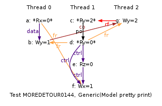

Executions for behaviour:
"0:R0=0 ; 1:R0=1 ; 1:R1=0"
"0:R0=1 ; 1:R0=1 ; 1:R1=0"
"0:R0=0 ; 1:R0=2 ; 1:R1=0"
"0:R0=1 ; 1:R0=2 ; 1:R1=0"
"0:R0=1 ; 1:R0=1 ; 1:R1=2"
ARM MOREDETOUR0144
"DpDatadW Rfe DetourR DpCtrldR DpCtrldW Rfe"
Cycle=Rfe DetourR DpCtrldR DpCtrldW Rfe DpDatadW
Prefetch=0:x=F,0:y=W,1:y=F,1:x=W
Com=Rf Rf
Orig=DpDatadW Rfe DetourR DpCtrldR DpCtrldW Rfe
%x0=x; %y0=y;
%y1=y; %z1=z; %x1=x;
%y2=y;
P0 | P1 | P2 ;
LDR R0,[%x0] | LDR R0,[%y1] | MOV R0,#2 ;
EOR R1,R0,R0 | LDR R1,[%y1] | STR R0,[%y2] ;
ADD R1,R1,#1 | CMP R1,R1 | ;
STR R1,[%y0] | BNE LC00 | ;
| LC00: | ;
| LDR R2,[%z1] | ;
| CMP R2,R2 | ;
| BNE LC01 | ;
| LC01: | ;
| MOV R3,#1 | ;
| STR R3,[%x1] | ;
Observed
0:R0=0; 1:R0=1; 1:R1=0;
and 0:R0=1; 1:R0=1; 1:R1=0;
and 0:R0=0; 1:R0=2; 1:R1=0;
and 0:R0=1; 1:R0=2; 1:R1=0;
and 0:R0=1; 1:R0=1; 1:R1=2;
