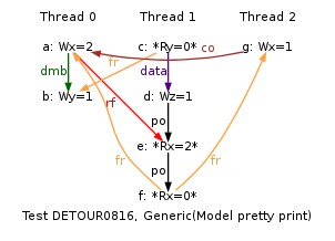

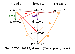

ARM DETOUR0816
"DMBdWW Rfe DpDatadW PodWR DetourR Fre"
Cycle=Rfe DpDatadW PodWR DetourR Fre DMBdWW
Prefetch=0:x=F,0:y=W,1:y=F,1:x=T
Com=Rf Fr
Orig=DMBdWW Rfe DpDatadW PodWR DetourR Fre
%x0=x; %y0=y;
%y1=y; %z1=z; %x1=x;
%x2=x;
P0 | P1 | P2 ;
MOV R0,#2 | LDR R0,[%y1] | MOV R0,#1 ;
STR R0,[%x0] | EOR R1,R0,R0 | STR R0,[%x2] ;
DMB | ADD R1,R1,#1 | ;
MOV R1,#1 | STR R1,[%z1] | ;
STR R1,[%y0] | LDR R2,[%x1] | ;
| LDR R3,[%x1] | ;
