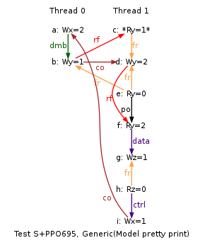

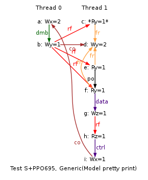

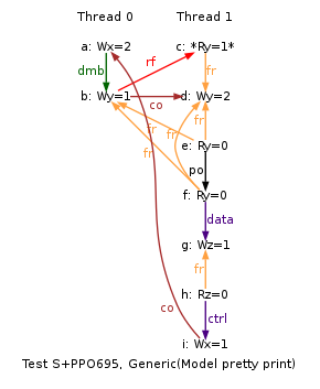

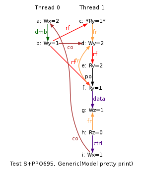

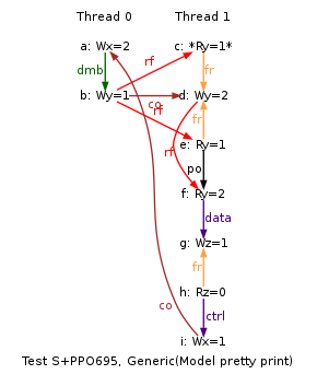

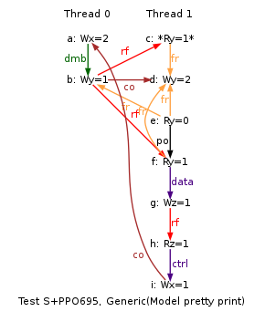

Test S+PPO695
Executions for behaviour: "1:R0=1 ; x=2 ; y=2"
ARM S+PPO695
"Wse DMBdWW Rfe PosRW PosWR PosRR DpDatadW PosWR DpCtrldW"
Cycle=Rfe PosRW PosWR PosRR DpDatadW PosWR DpCtrldW Wse DMBdWW
Safe=Rfe Wse PosWR PosRW PosRR DMBdWW DpDatadW DpCtrldW
Prefetch=0:x=F,1:x=W
Orig=Wse DMBdWW Rfe PosRW PosWR PosRR DpDatadW PosWR DpCtrldW
 P0            | P1             ;
 MOV R0, #2    | LDR R0, [%y1]  ;
 STR R0, [%x0] | MOV R1, #2     ;
 DMB           | STR R1, [%y1]  ;
 MOV R1, #1    | LDR R2, [%y1]  ;
 STR R1, [%y0] | LDR R3, [%y1]  ;
               | EOR R4,R3,R3   ;
               | ADD R4, R4, #1 ;
               | STR R4, [%z1]  ;
               | LDR R5, [%z1]  ;
               | CMP R5, R5     ;
               | BNE LC00       ;
               | LC00:          ;
               | MOV R6, #1     ;
               | STR R6, [%x1]  ;
    1:R0=1; x=2; y=2;
