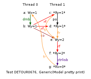

Test DETOUR0676
Executions for behaviour: "1:R0=0 ; 1:R1=1 ; 1:R3=2 ; 1:R4=0"

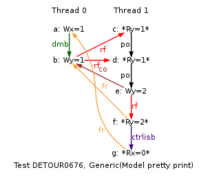

Executions for behaviour: "1:R0=1 ; 1:R1=1 ; 1:R3=2 ; 1:R4=0"

    1:R0=0; 1:R1=1; 1:R3=2; 1:R4=0;
and 1:R0=1; 1:R1=1; 1:R3=2; 1:R4=0;
